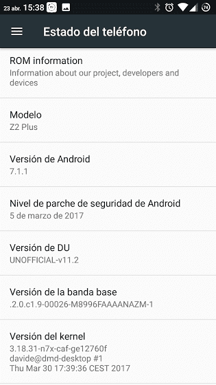

ROM OS Version: 7.x Nougat
ROM Kernel: Linux 3.18.x
