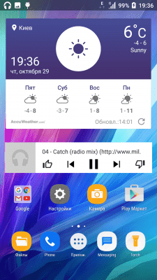

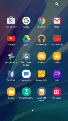

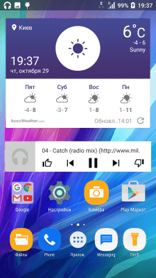

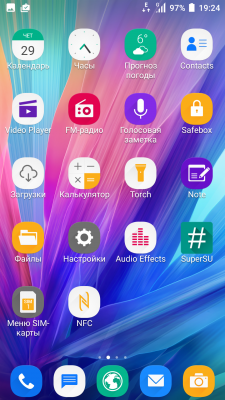

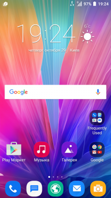

Slides:
Reduced by 80%
1080 x 1920 (1.64 MB)
Reduced by 80%
1080 x 1920 (1.75 MB)
Reduced by 80%
1080 x 1920 (1.24 MB)
Reduced by 80%
1080 x 1920 (118.99 KB)
Reduced by 80%
1080 x 1920 (1.06 MB)
Reduced by 80%
1080 x 1920 (1.03 MB)
Reduced by 80%
1080 x 1920 (157.63 KB)
Reduced by 80%
1080 x 1920 (127.61 KB)
